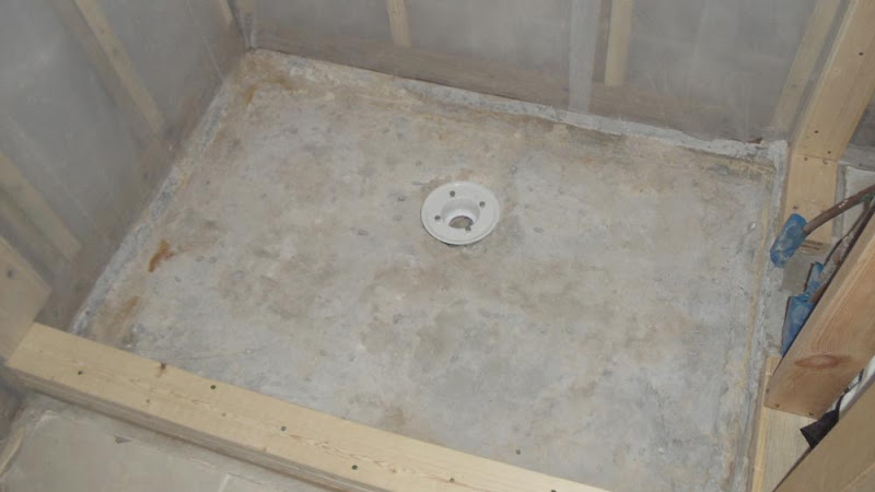

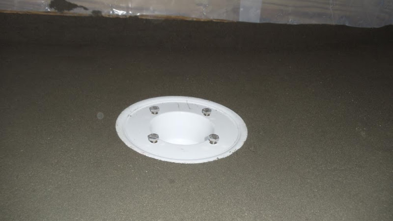

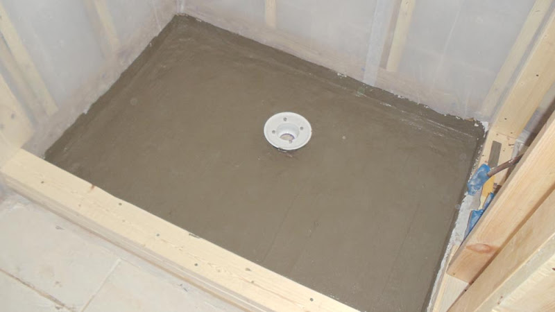

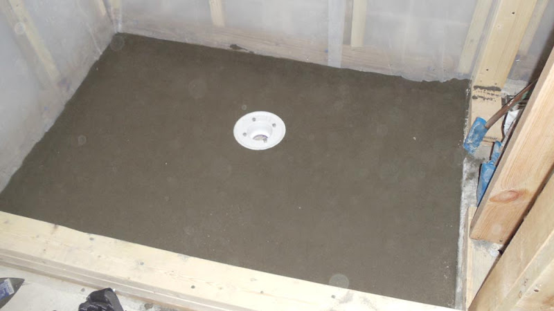

#16222 - 10/09/10 10:35 PM Re: New here, new to tile, and i have a new project. [Re: Kman]
ploeg8393 Offline
New Member
Registered: 07/05/10
Posts: 17
Loc: Orlando, FL
Drain in, ready to start.
Bond Coat
Finished, I guess i should have cleaned the cement dust off my camera...
How long should this cure? It is Mapei 4/1.
Edited by ploeg8393 (10/09/10 10:53 PM)
