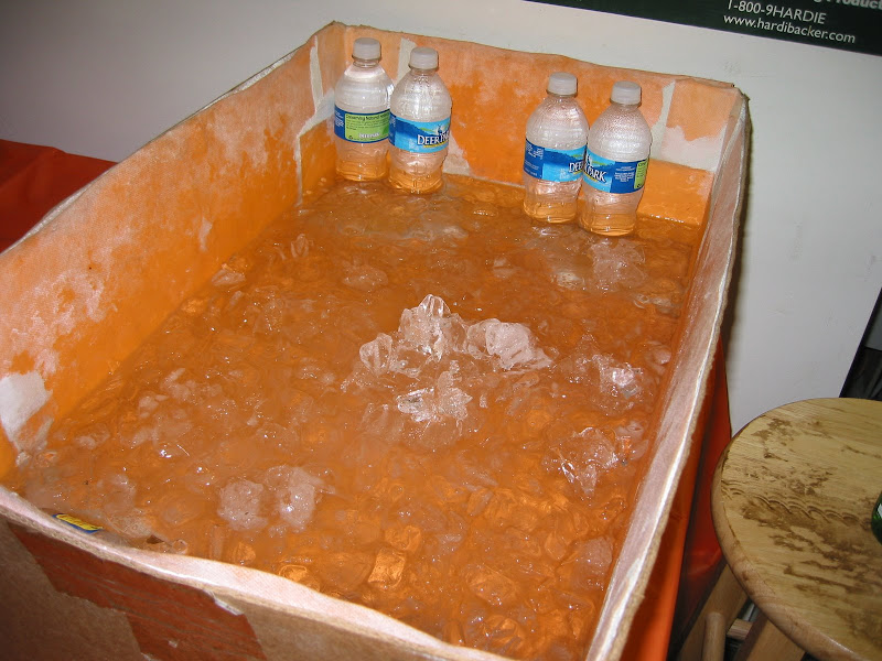

It makes no difference which way the overlaps go. This is not shingles on your roof. The 2" overlap is way overkill too. By actual testing Schluter claims they have never encountered any wicking more than 1/4". Kerdi will hold water.
