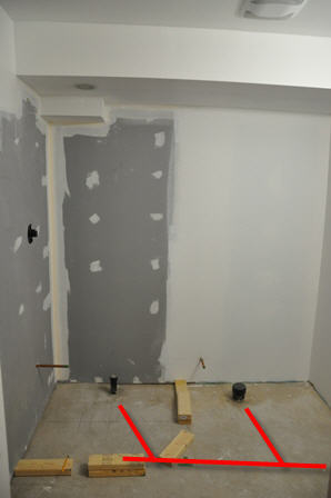

The Bathroom area cannot be made larger since walls are in place. The bath room size is around 6.5'x6.5' feet.
Based on pictures taken during house construction, the pipes are directed per red lines.
Question about centering the toilet pipe.
Also note that the 3" pipe for the toilet is not perfectly centered between the planned shower section and the wall. I will have to move it about 4-5 inches towards the side wall (right)to get a perfect center. Based on your experience - should I bother with moving the toilet roughin to get a perfect center? Once the tiles and finishing are in place, would it look funny to have the toilet non-centered? I am planning to use glass walls on the shower. We thought about adding some corner shelving furniture to disguise the non centered toilet. I'm a bit hesitant to break the concrete /move the toilet pipe 5" and not sure if I can even do that without changing too much of the underlying pipes.
Hoping to hear your expert advice if its worth centering the toilet.

#16833 - 03/11/11 06:38 PM Re: Basement Bathroom Project [Re: atm]
Kman Offline
Senior Member
Registered: 08/07/06
Posts: 854
Loc: Pea Ridge, Arkansas
I wouldn't bother with it, but that's just my opinion. That extra space looks like a good place for a magazine rack....or a television. laugh

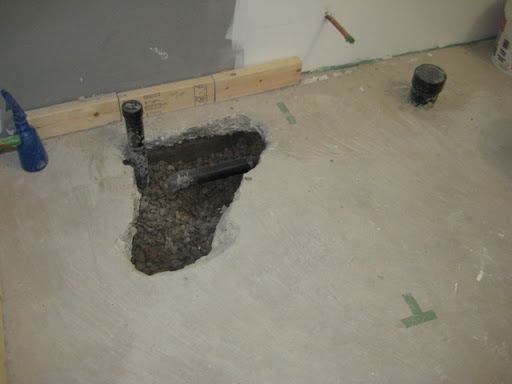

Rented a power tool to help crack open the concrete. It took less than 2 hours to get to this stage. It appears that the pipe is connecting to the toilet rough-in piping rather than to the main pipe as initially thought smile
Question on the Toilet rough-in.
While I have the power tool, do I need to crack open the cement around the 3" toilet rough-in to be able to install the flange? I think there are two different flange types, one that fits inside and another that fits outside the 3" pipe. Which one should I use? Note that the 3"pipe is 10" center away from the wall. I was planning to use the 10" rough-in toilets for this.
I was also considering using an offset flange to shift the location of the toilet towards the right to make it less off centered. Do you know how much distance I can gain using the offset flange? Is it ok to use it?
Question on cement
Wondering how many cement bags I would need to fill the opening? I plan to put back the stones then cover with concrete. do I need to leave the stones to settle for some time before applying the cement?
Thanks again!!!

#16839 - 03/13/11 10:30 AM Re: Basement Bathroom Project [Re: atm]
RC Offline
Senior Member
Registered: 10/21/03
Posts: 1797
Loc: Ontario, Canada
I think if you're planing on breaking out concrete for the toilet flange you might as well go all the way and offset a new flange the correct distance from the wall along with centering the rough-in between the shower and the wall.
An offset toilet flange will only give you approx. 1-1/2"of offset.
After you refill the hole, measure the final width,length and depth to calculate the cubic inches. Convert that measurement to cubic feet. Each bag of concrete mix will give you .5 cubic feet of cement.
Pack the fill in the trench as best as possible. Be careful around the pipes so that you don't alter the slope.
On a side note, I see that the DensShield has been paper taped in the corner. This needs to be removed along with any other drywall compound that's within the shower area.
